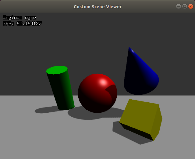

The following scenes have more primitive objects such as cones or cylinders. Again, you can see the scene with different render engines pressing Tab. Some of the scenes available include:

The AllShapesSceneBuilder class inside SceneBuilder.cc will define more objects such us: CYLINDER, CONE or BOX.
void AllShapesSceneBuilder::BuildScene(ScenePtr _scene)
SimpleSceneBuilder::BuildScene(_scene);
VisualPtr root = _scene->RootVisual();
VisualPtr cylinder = _scene->CreateVisual(CYLINDER);
cylinder->AddGeometry(_scene->CreateCylinder());
cylinder->SetLocalPosition(3.3, 1.0, 0.5);
cylinder->SetLocalRotation(0.0, -0.5, 0.0);
cylinder->SetLocalScale(0.5, 0.5, 1.5);
cylinder->SetMaterial("Green");
root->AddChild(cylinder);
VisualPtr cone = _scene->CreateVisual(CONE);
cone->AddGeometry(_scene->CreateCone());
cone->SetLocalPosition(2.6, -0.8, 1.2);
cone->SetLocalRotation(-0.5, -0.75, 0.0);
cone->SetLocalScale(0.8, 0.8, 1.0);
cone->SetMaterial("Blue");
root->AddChild(cone);
VisualPtr box = _scene->CreateVisual(BOX);
box->AddGeometry(_scene->CreateBox());
box->SetLocalPosition(2.2, -0.8, 0.2);
box->SetLocalRotation(GZ_PI / 4, 0.0, GZ_PI / 4);
box->SetLocalScale(0.5, 0.5, 0.5);
box->SetMaterial("Yellow");
root->AddChild(box);
