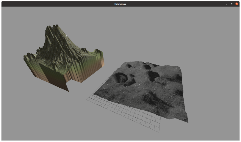

This example shows how to add a heightmap to the scene.
It loads 2 different heightmaps (image and Digital Elevation Model (DEM)) with different parameters.

A heightmap is a terrain defined by a 2D grid of height values. The example 1 demo, loads the heights from a grayscale image, where the color black represents the lowest point and white represents the heights. Example 2, loads the heights from the DEM file itself.
The heightmap's information is stored in the HeightmapDescriptor class. In addition to the height data, the heightmap descriptor also exposes functionality such as:
  • Its size in meters in XYZ space.
  • The position of its origin in the world.
  • The textures to use according to the height.
  • How to blend these textures.

And a snippet that adds a DEM heightmap to the scene:

Note, since DEMs encode elevation data, the minimum elevation for the moon.tif DEM is -212.296. We need to translate the DEM for it to be at z = 0 by setting the descriptor's z position to be 212.296 or desc2.SetPosition({0, 0, std::abs(data2->MinElevation())});.
