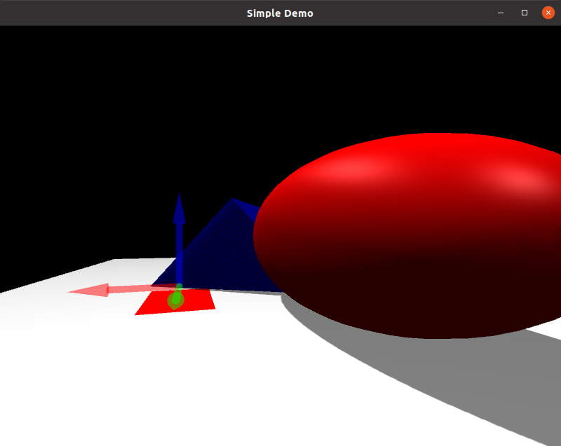

The material API allows changing the render order. When polygons are coplanar, you can get problems with depth fighting (also known as z fighting) where the pixels from the two polys compete for the same screen pixel. As you can see in the following image:
The method SetRenderOrder in the Material class allows you to avoid this issue. The higher value will be rendered on top of other coplanar polygons. This method will set the depth bias value of objects that the material is assigned to.
In the simple_demo example you can find two materials with different render orders. The red material (SetRenderOrder(3)) has a higher value than the white material (SetRenderOrder(3)).

As you can see in the following image the depth fighting issue is resolved.
