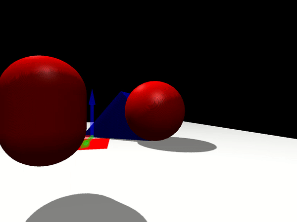

Simple demo
This example shows how move the camera automatically.
cd gz-rendering/examples/simple_demo
# Linux
cmake --build .
# Windows
cmake --build . --config Release
# Linux
./simple_demo
# Windows
.\Release\simple_demo
[Msg] Loading plugin [gz-rendering10-ogre]
The function updateCameras() is called each time the DisplayCB function runs. Using the method SetLocalPosition from the Camera class we can move the camera in the world:
void updateCameras()
double angle = g_offset / 2 * GZ_PI;
double x = sin(angle) * 3.0 + 3.0;
double y = cos(angle) * 3.0;
for (ir::CameraPtr camera : g_cameras)
camera->SetLocalPosition(x, y, 0.0);
g_offset += 0.0005;
