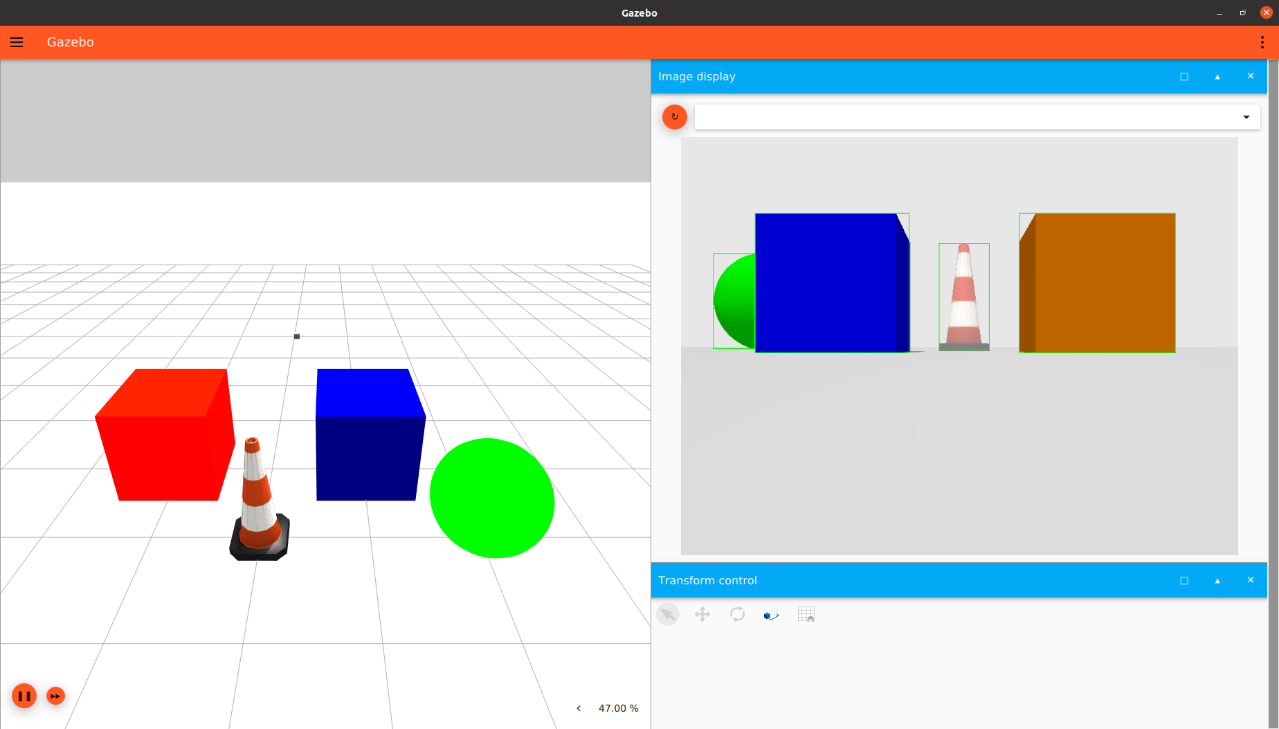

You should see something similar to this:
visible_boxes
Note that the mode was visible 2d, so that the occluded sphere has a bounding box on just the visible part of it, that is the way of the annotation in famous datasets such as COCO & PASCAL VOC datasets.

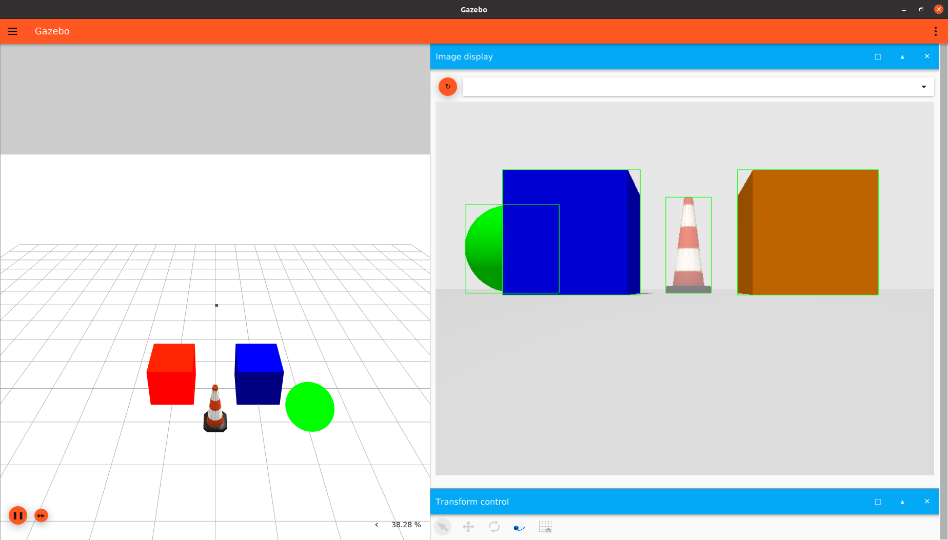

Change the <box_type> to full_2d to see the full bounding boxes mode which shows the full box of the occluded objects, and this mode is implemented in datasets such as KITTI and nuscenes, and it is benefit in the case that you need a the model to guess the hidden parts of the objects!.
You will see output like this:
full_boxes

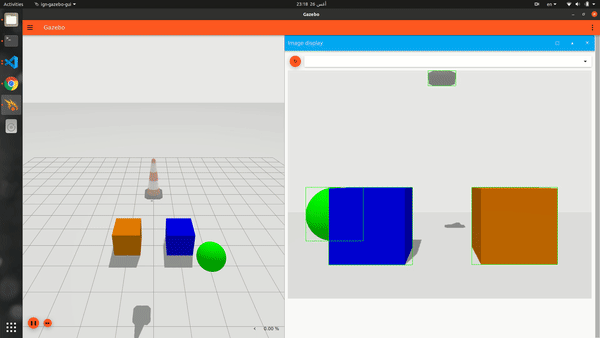

Set up the path of the dataset and run:
gz sim boundingbox_camera.sdf
you will find that the dataset is saved in the given path
Dataset Demo

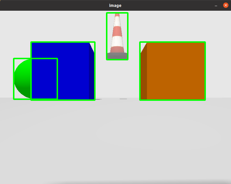

visualize_2d

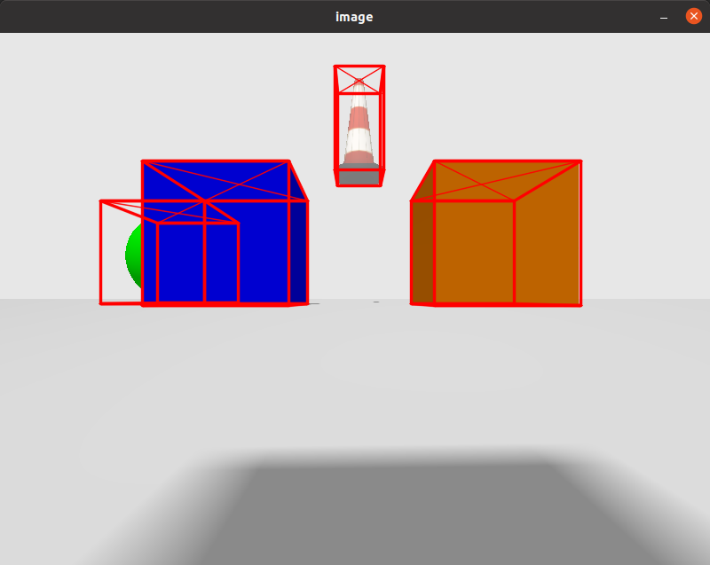

Try to change the <box_type> to 3d then generate the dataset again, then visualize it using the following code

Note that, you shouldn't change the camera configuration to use that code, or you have to change the porjection matrix that is specified in the code.
You should see output like this
visualize_3d

In the example above, the bounding box cameras publish an axis aligned 2d bounding box message in case of 2d boxes mode (visible 2d or full 2d) or a oriented 3d bounding box message to the topic provided in the <topic> tag in SDF For example, in the next code we publish on the topic “boxes”
<sensor name="boundingbox_camera" type="boundingbox_camera">
<topic>boxes</topic>
The camera also publishes an image message of an image with the bounding boxes drawn on it(not valid in case of 3d boxes), and it publish it on topic “TOPIC_TAG_NAME_image”, for example, in the above code, it will publish the image message on “boxes_image”.
We can see the bounding boxes by running the following command:
topic -e -t TOPIC_TAG_NAME
In the above example, it will be:
topic -e -t boxes

void OnNewBoxes3D(const gz::msgs::AnnotatedOriented3DBox_V &_msg)
int size = _msg.annotated_box_size();
std::cout << "Reveived [" << size << "] 3D bounding boxes: " << std::endl;
for (int i = 0; i < size; i++)
gz::msgs::AnnotatedOriented3DBox annotatedBox = _msg.annotated_box(i);
std::cout << annotatedBox.DebugString() << std::endl;

To run the sensor in 3d boxes mode, give it argument 3d, for example: ./executable_name 3d
