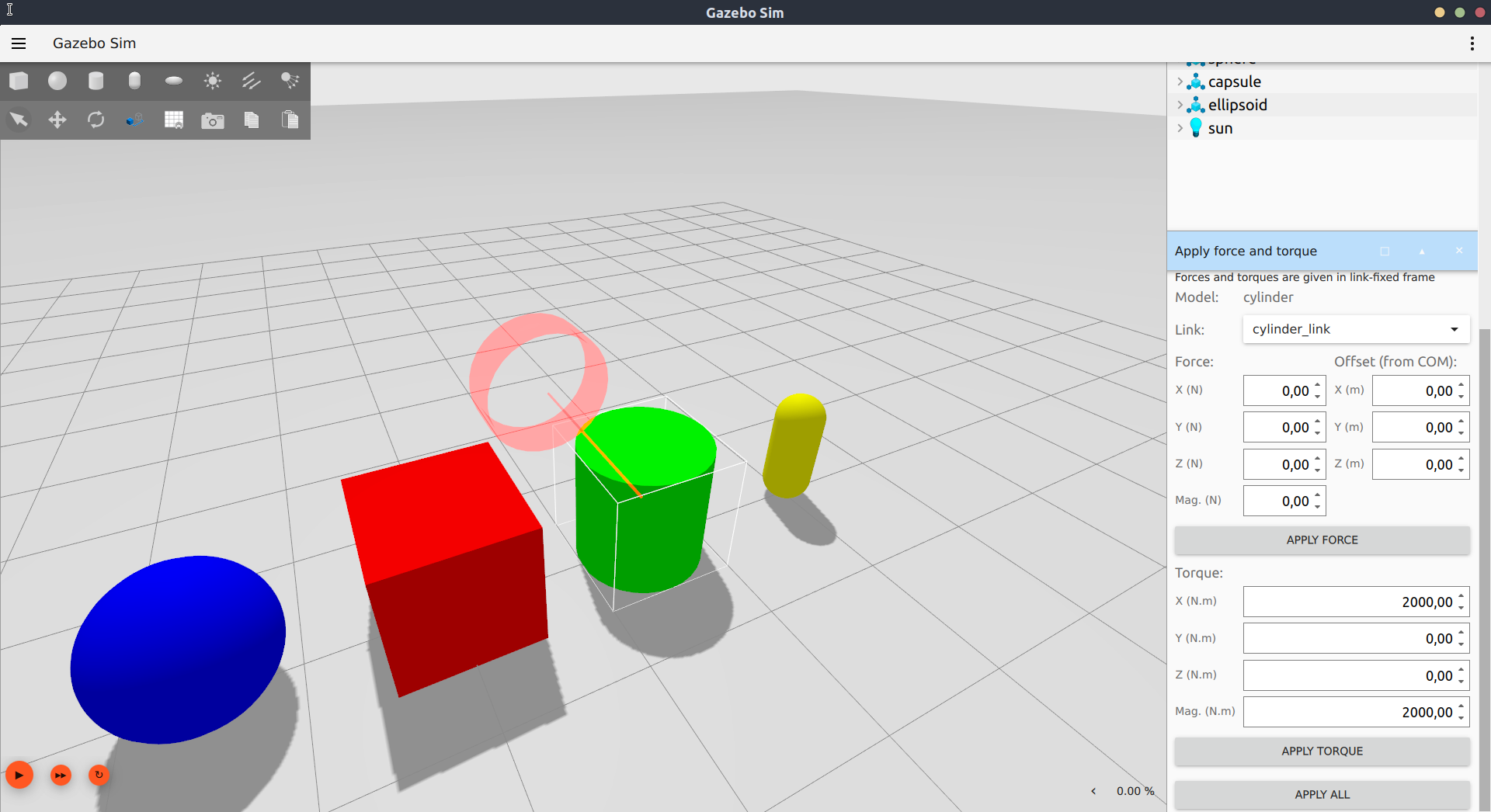

Apply torque to a link
On the dialog, write 2000 on the X field under Torque and click on Apply Torque to see the cylinder rotate slightly.

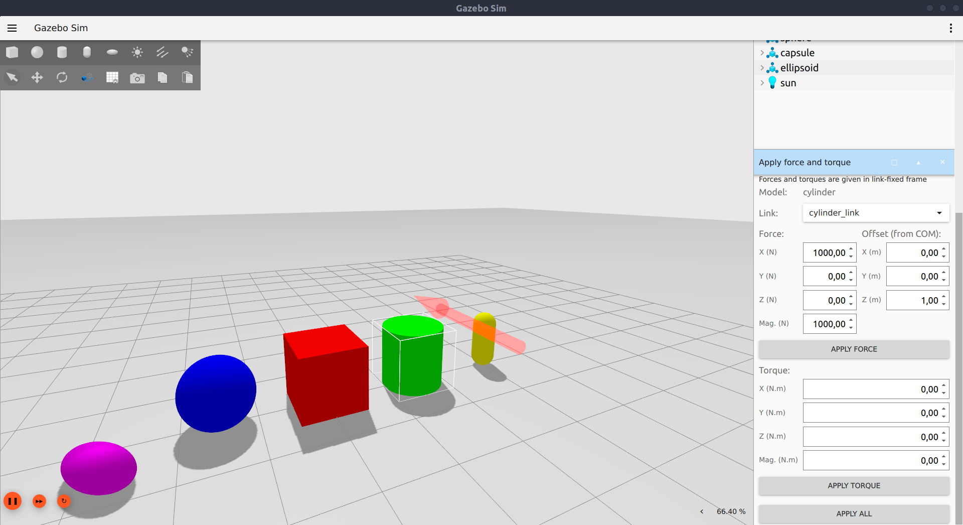

Apply force with an offset
By default, the force is applied to the link's center of mass, but this can be modified through the Offset fields. On the dialog, write 1000 on the X field under Force and 1 under the Z field under Offset. Press Apply Force to see the model move slightly in the X direction while also rotating around the Y direction.

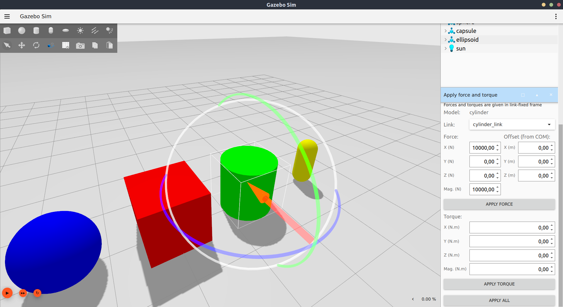

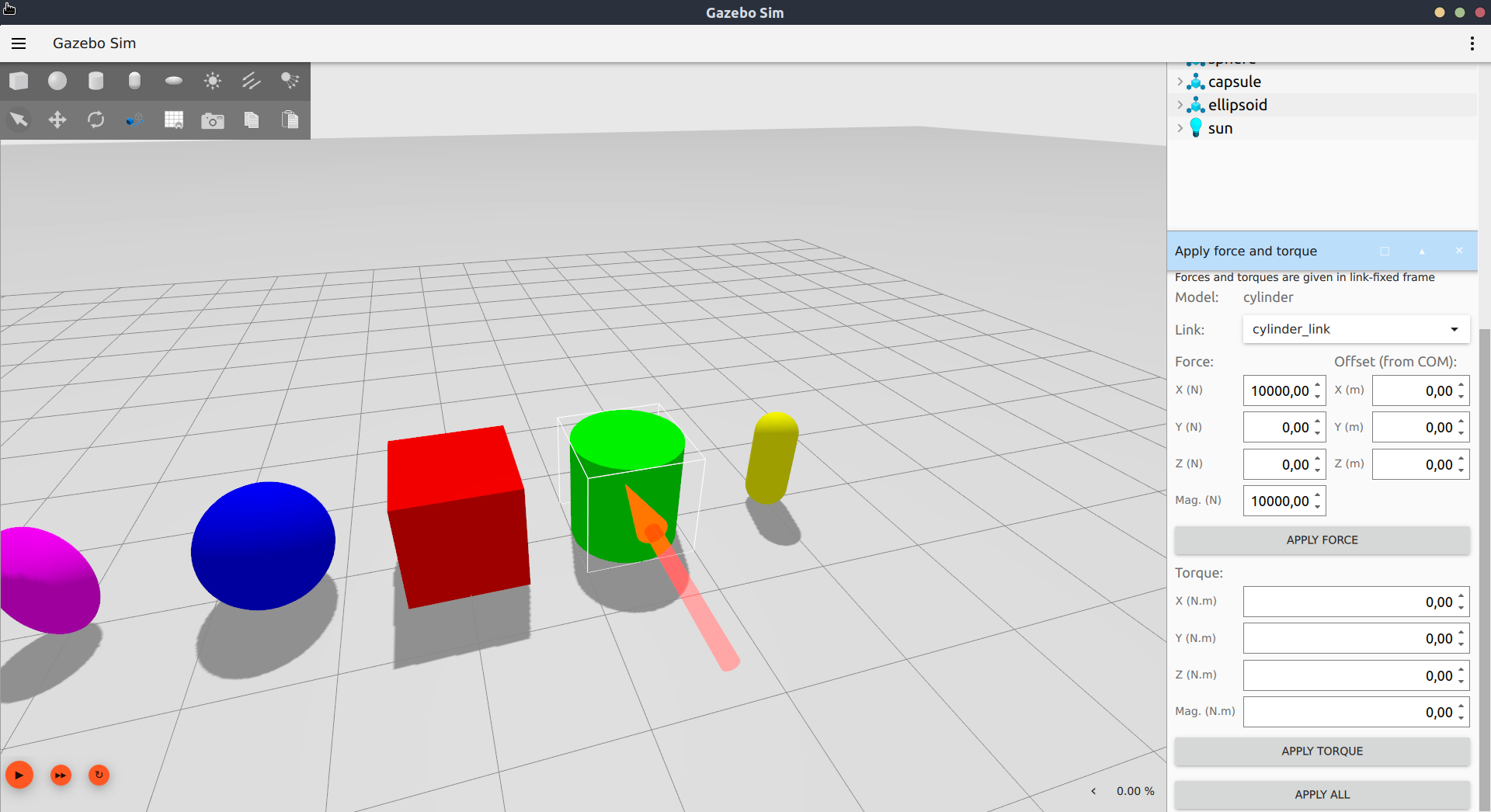

Rotation tool
On the dialog, write 10000 on the X field under Force. Click on the force vector to make the rotation tool appear. Drag the blue circle to rotate the force around the Z axis so that it is aligned with the Y direction. Notice how the XYZ fields changed, but not the magnitude. Press Apply Force to see the model move in the Y direction.
