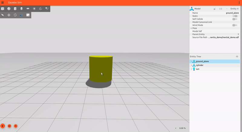

Here's an example snippet of a cylinder model that has automatic inertial calculations enabled and has a density of 1240 kg/m^3:
<model name="cylinder">
<link name="cylinder_link">
<inertial auto="true" />
<density>1240.0</density>
<cylinder>
<radius>1</radius>
<length>2</length>
</cylinder>
<cylinder>
<radius>1</radius>
<length>2</length>
</cylinder>
<diffuse>1.0 1.0 0.0 1.0</diffuse>
<ambient>1.0 1.0 0.0 1.0</ambient>
<specular>1.0 1.0 0.0 1.0</specular>
If you use the above snippet in an empty world and launch it with gz-sim, here's how it would look:
Cylinder

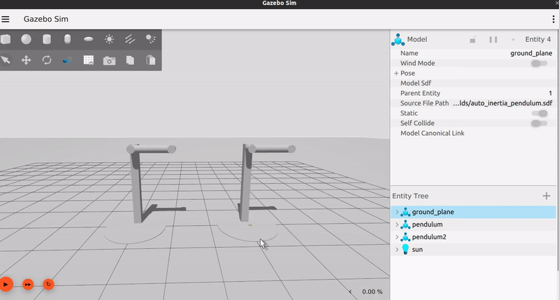

To understand the inertia calculation in links with multiple collisions and the effect of setting different density values, you can launch the auto_inertia_pendulum.sdf example world using:
gz sim auto_inertia_pendulum.sdf
After the gz-sim window opens up, you can right click on both the models and enable the centre of mass visualization by selecting the View > Center of Mass option from the menu. Once you play the simulation it should look this:
Pendulum
This example world has two structurally identical models. The pendulum link of both the models contain 3 cylindrical collision geometries:
  • One on the top which forms the joint (pivot)
  • A longer cylinder in middle
  • One at the end which forms the bob of the cylinder.
Even, though they are identical, the center of mass for both are different as they use different density values for the different cylinder collisions. On one hand, the upper joint collision of the pendulum on the left has the highest density which causes the center of mass to shift closer to the axis. While on the other hand, the bob collision of the pendulum on the right has the highest density which causes the center of mass to shift towards the end of the pendulum. This difference in mass distribution about the axis of rotation results in a difference in the moment of inertia of the 2 setups and hence different angular velocities.

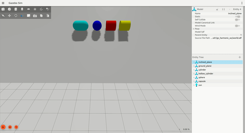

Mesh Inertia Calculation with Rolling Shapes Demo
Let's try another example world, auto_inertia_rolling_shapes.sdf. This can be launched with gz sim using the following command:
gz sim auto_inertia_rolling_shapes.sdf
Once you launch and play the simulation, it should look something like this:
Rolling
Here the right most shapes is a hollow cylinder (yellow). This model is loaded from Gazebo Fuel and is made using a collada mesh of a hollow cylinder. Apart from this, we can see there is a solid cylinder, a solid sphere and a solid capsule. All of these are made using the <geometry> tag and have automatic inertia calculations enabled. Here, the moments of inertia for the hollow cylinder (which is a non-convex mesh shape) is calculated and from the simulation we can see that it reaches the bottom of the incline last. This is physically accurate as the mass distribution for the hollow cylinder is concentrated at a distance from the axis of rotation (which passes through the center of mass in this case).
