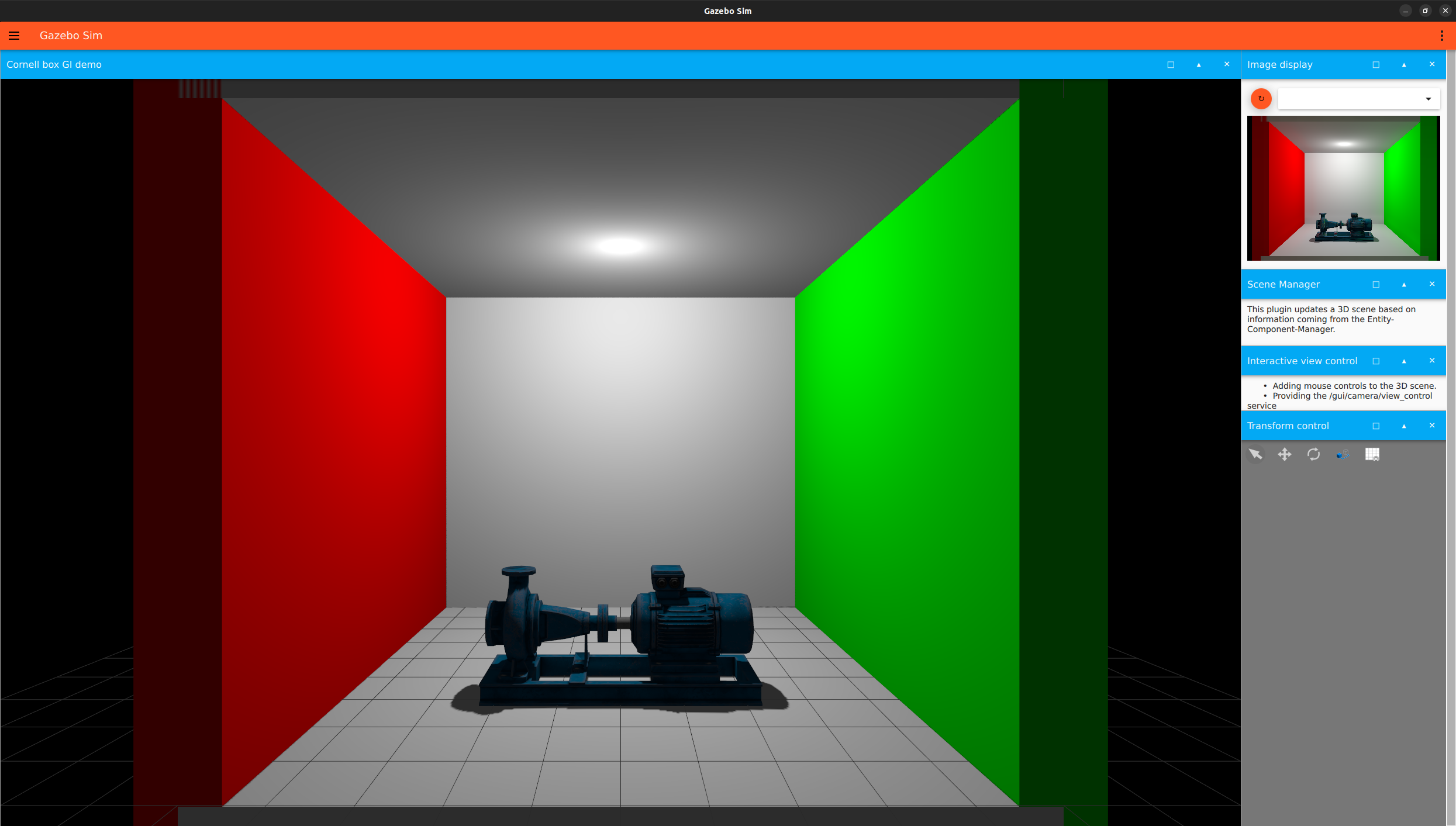

Enabling global illumination in Gazebo
During simulation, the GUI and the camera sensor view are two different scenes. The GUI scene is rendered on the frontend client process, and the camera sensor scene is rendered on the backend server process. Thus, GI can be enabled on either or both of these processes.
‍Note: GI solutions require hardware that uses OpenGL4.
Note: CI VCT must be run with Vulkan as the render engine API backend.

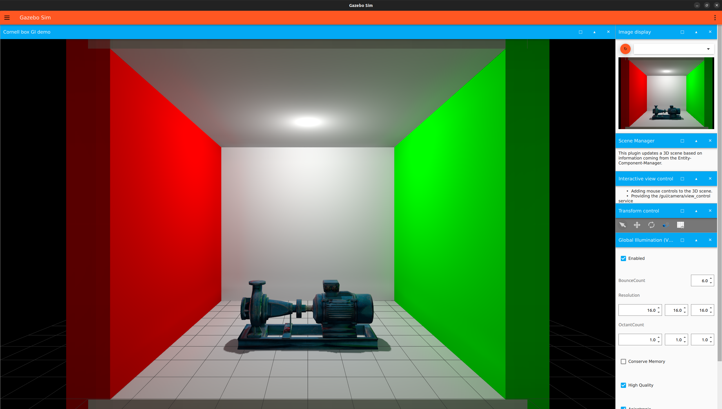

How to enable global illumination for the GUI
GI can be enabled for the GUI through a GUI plugin. Both VCT and CI VCT are supported for the GUI.
Example usage for VCT
1) Open the global_illumination.sdf world with
gz sim global_illumination.sdf
2) From the plugin dropdown, select the Global Illumination Vct plugin.
3) On the card, check the Enabled button to enable GI and change the parameter values as desired.
Example usage for CI VCT
1) Open the global_illumination.sdf world using Vulkan with
gz sim global_illumination.sdf --render-engine-api-backend vulkan
2) From the plugin dropdown, select the Global Illumination Ci Vct plugin.

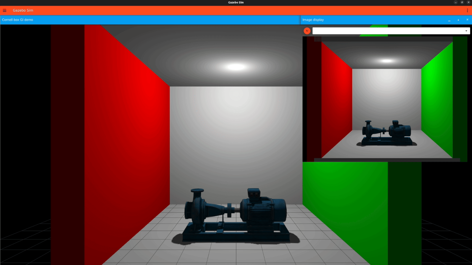

How to enable global illumination for the sensor
GI can be enabled for sensors through the <global_illumination> element in the Sensors System plugin. VCT is supported for the sensor.
Example usage with VCT
We will demonstrate how to enable VCT for the sensor with the SDF file below. (The finished SDF file can be viewed here.)
1) Save the below in an SDF file named gi_demo.sdf:

2) Add the <global_illumination> element to the Sensors System plugin.
<global_illumination type="vct">
<enabled>true</enabled>
<resolution>16 16 16</resolution>
<octant_count>1 1 1</octant_count>
<bounce_count>6</bounce_count>
<high_quality>true</high_quality>
<anisotropic>true</anisotropic>
<thin_wall_counter>1.0</thin_wall_counter>
<conserve_memory>false</conserve_memory>
<debug_vis_mode>none</debug_vis_mode>
</global_illumination>
The parameters can be changed from the default values.
3) Open the gi_demo.sdf world with
gz sim gi_demo.sdf
