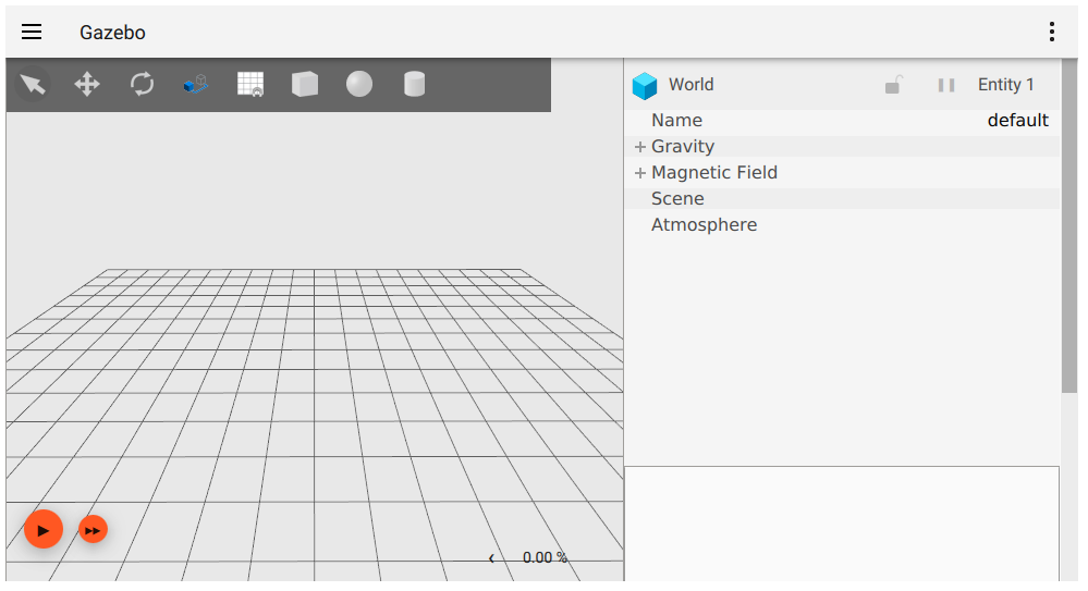

Let's try this in practice. First, let's open the default Gazebo world:
gz sim default.sdf
You should see an empty world with several plugins loaded by default, such as the 3D Scene, the play/pause button, etc.

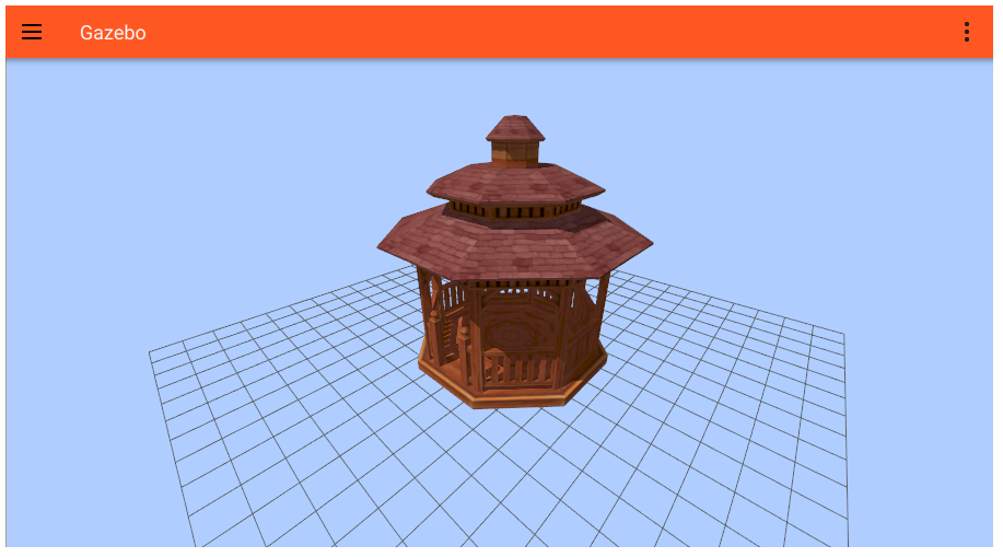

Now let's load this world:
gz sim <path to>/fuel_preview.sdf
Notice how the application has only 3 GUI plugins loaded, as defined on the SDF file above.

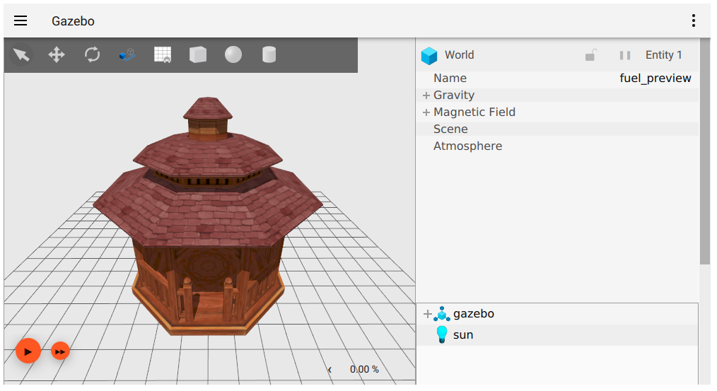

Now, let's change the policy so that default plugins are included
<?xml version="1.0" ?>
<sdf version="1.6">
<world name="fuel_preview">
filename="gz-sim-scene-broadcaster-system"
name="gz::sim::systems::SceneBroadcaster">
<gz:policies>
<include_gui_default_plugins>true</include_gui_default_plugins>
</gz:policies>
<gui fullscreen="0">
<!-- 3D scene -->
<plugin filename="MinimalScene" name="3D View">
<gz-gui>
<title>3D View</title>
<property type="bool" key="showTitleBar">false</property>
<property type="string" key="state">docked</property>
</gz-gui>
<engine>ogre2</engine>
<scene>scene</scene>
<ambient_light>1.0 1.0 1.0</ambient_light>
<background_color>0.4 0.6 1.0</background_color>
<camera_pose>8.3 7 7.8 0 0.5 -2.4</camera_pose>
<plugin filename="GzSceneManager" name="Scene Manager">
<gz-gui>
<property key="resizable" type="bool">false</property>
<property key="width" type="double">5</property>
<property key="height" type="double">5</property>
<property key="state" type="string">floating</property>
<property key="showTitleBar" type="bool">false</property>
</gz-gui>
<plugin filename="InteractiveViewControl" name="Interactive view control">
<gz-gui>
</gz-gui>
</gui>
<uri>https://fuel.gazebosim.org/1.0/OpenRobotics/models/Sun</uri>
<uri>https://fuel.gazebosim.org/1.0/OpenRobotics/models/Gazebo</uri>
</world>
</sdf>
You will now see the same model loaded in the default GUI layout similar to when you deleted the <gui> element altogether. Note that this will also be the behavior if we removed <include_gui_default_plugins> tag.

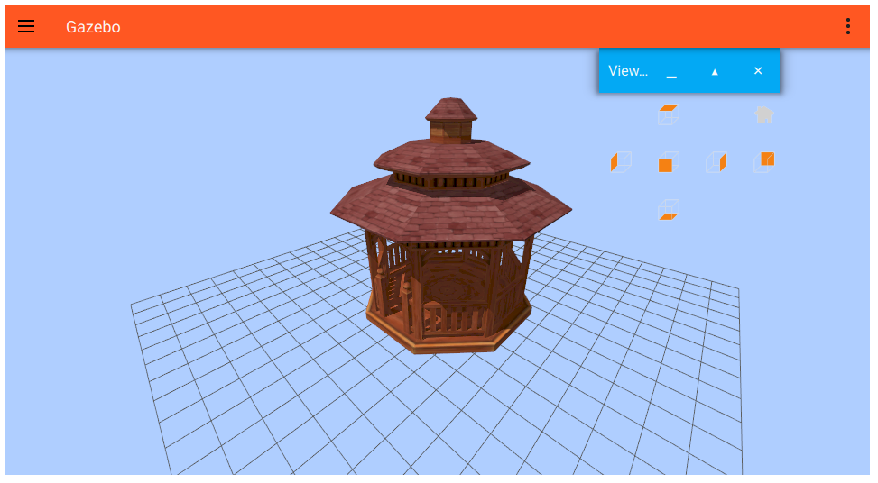

  2. Now from the top-right menu, choose to add the "View Angle" plugin. This plugin has convenient buttons to change the camera angle, try them out!
  3. Undock the inserted plugin by clicking on the □ button on top of it.
  4. Now that the plugin is floating, drag it to any place you want.
  5. Finally, let's save our configuration by going to the top-left menu and choosing "Save client configuration as".
  6. Save the file at a path of your choice, and name it saved.config.
