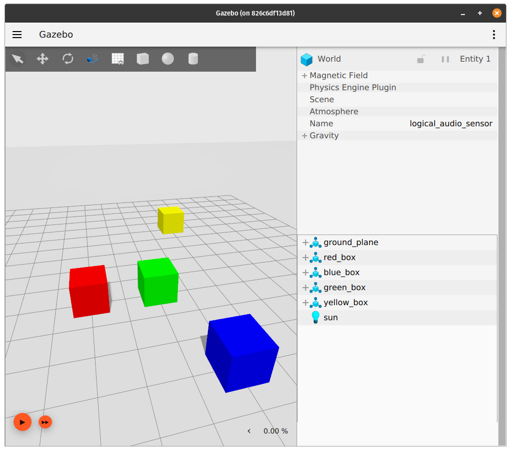

Let's use the SDF file introduced above (logical_audio_sensor_plugin.sdf) to see how sources and microphones interact in an environment.
Start a simulation that uses this SDF file by running the following command in a terminal:
gz sim logical_audio_sensor_plugin.sdf
You should see a something like this:
