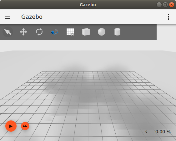

You should see the fog slowly starting to appear from the ground plane in the world:

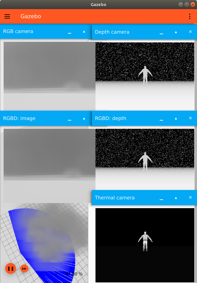

Navigate to the Visualize Lidar plugin on the right and click on the refresh button to set the lidar topic. You should see the sensor images and lidar visualization like below:
The two image displays on the left show the images from a regular camera sensor and RGB output of a RGBD camera. The two have very similar color image output that shows the fog in the camera view. To their right are the depth images produced by a depth camera and the depth output of the RGBD camera. The depth readings are noisy due to the particle scattering effect. You can also see that these sensors can partially see through the fog and detect the rescue randy inside it. The bottom left of the gif shows the lidar visualization; the range data are also affected by the scattering effect. Finally, the thermal camera image display on the bottom right shows that thermal cameras do not detect particles.
