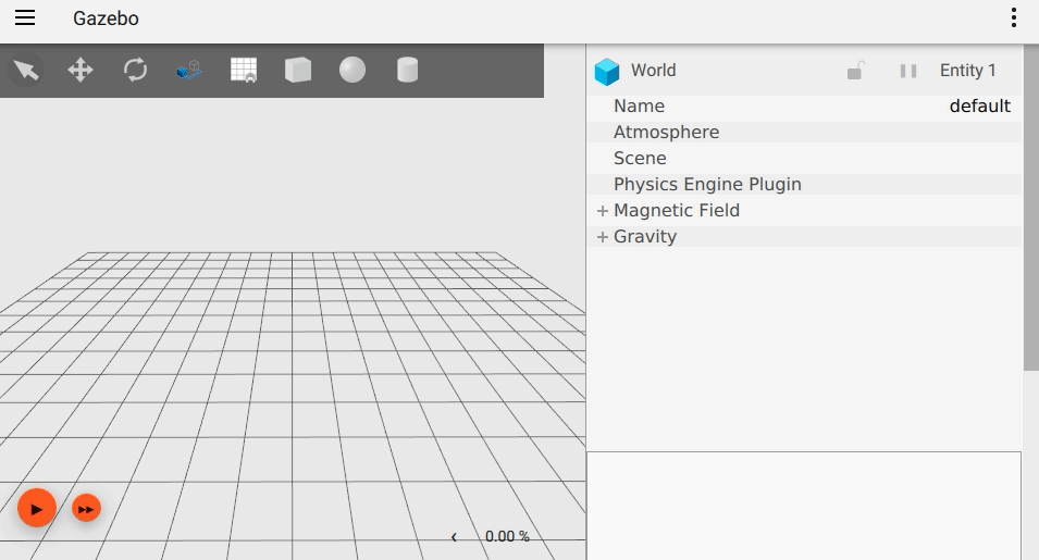

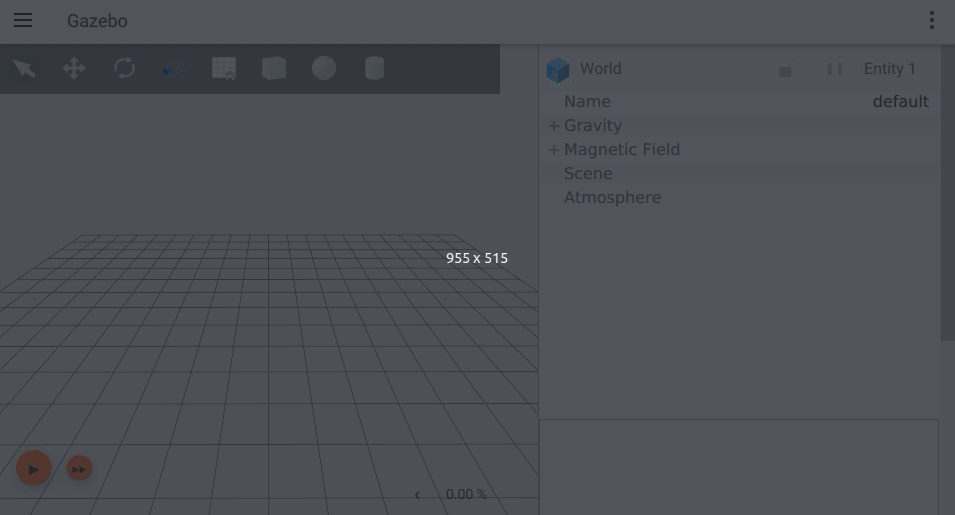

  2. Remove the <plugin> block for the physics system
  3. Reload Gazebo:
    gz sim
Now insert a shape and press play: it shouldn't fall because physics wasn't loaded.

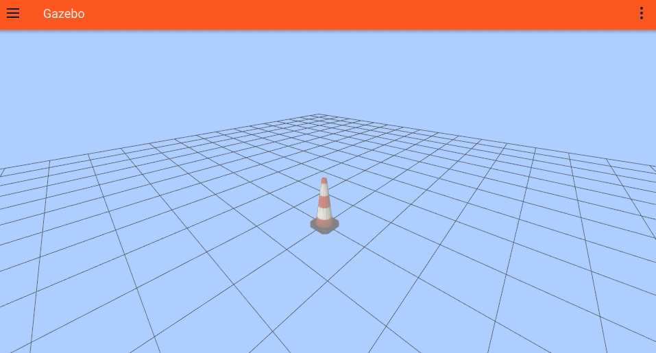

Notice how the application has loaded the scene broadcaster, as defined on the SDF file above as well as the default plugins Physics and UserCommands. Since SceneBroadcaster is loaded from the SDF file, it's not loaded again. We see that the cone falls due to gravity since all the necessary plugins are loaded.

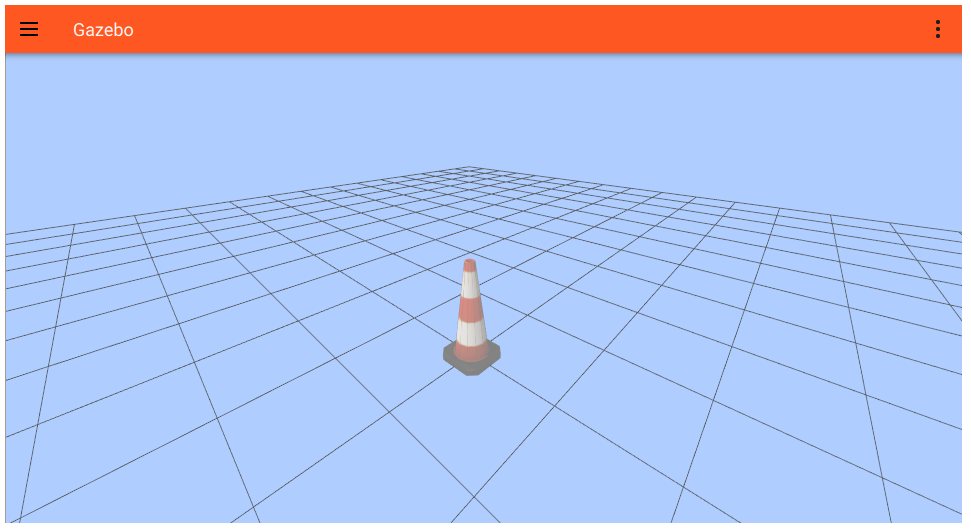

Notice how the application has only one system plugin loaded, the SceneBroadcaster, as defined on the SDF file above. Physics is not loaded, so even though the simulation is running (started with -r), the cone doesn't fall with gravity.
If you delete the <plugin> element from the file above and reload it, you'll see the same model loaded with the default plugins, so it will fall.

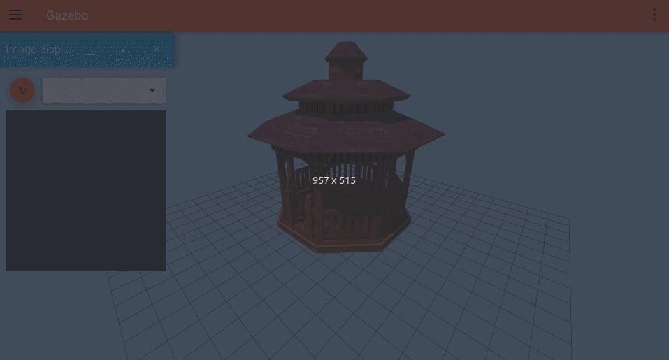

You'll see a world with a camera and a cone. If you refresh the image display plugin, it won't show any image topics. That's because the default server configuration doesn't include the sensors system, which is necessary for rendering-based sensors to generate data.

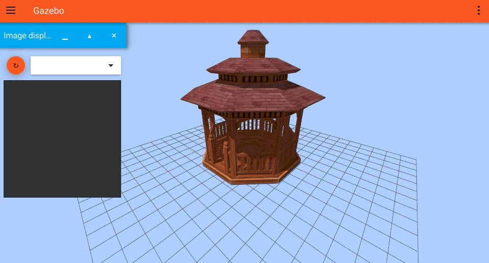

Now when we launch the simulation again, refreshing the image display will show the camera topic, and we can see the camera data. One interesting thing to notice is that on the camera view, there's no grid and the background color is the default grey, instead of the blue color set on the GUI GzScene plugin.
