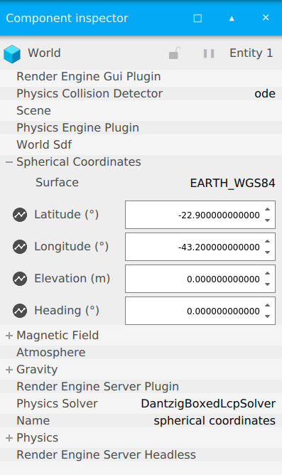

On the component inspector, expand the Spherical Coordinates component to see that the coordinates were set correctly:

To change the world origin through the GUI, edit values within the component inspector shown above, and these changes will be reflected on simulation.
