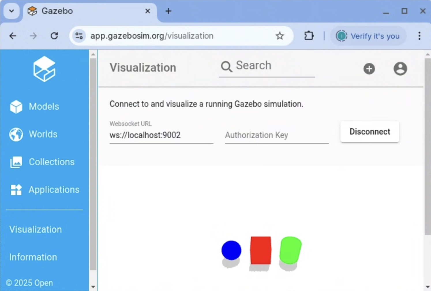

In this example, the websocket server will be launched on port 9002, the data published to gzweb are throttled at 30Hz, and the server has no limit on the maximum number of client connections. Authorization and SSL settings can also be configured.
See more information on the plugin parameters and how to launch gzweb in the websocket server demo

    Check the console output in the terminal that you used to launch gz sim and verify that the websocket server is started.
