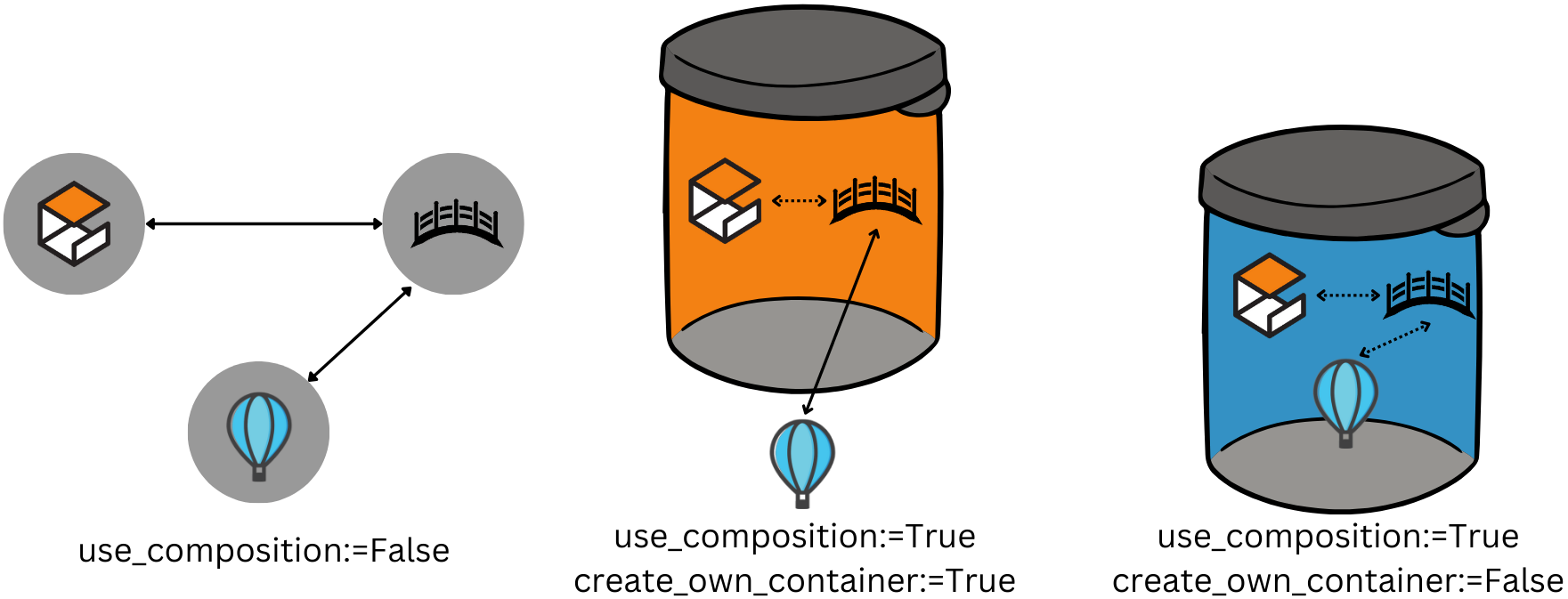

If you inspect the parameters of the launch files mentioned in the next tutorials, you’ll notice that we have included in most cases two parameters named use_composition and create_own_container. When the use_composition parameter is set to True, the associated ROS node will be loaded within a ROS container. When this happens, all the nodes within the same ROS container share the same process and can leverage intraprocess communication.
The parameter create_own_container only makes sense when use_composition is set to True. This parameter lets you control whether you start a ROS container for your composable nodes or you defer to an external ROS container.
Our recommendation is to always set the use_composition parameter to True and decide if you need to create your own container based on your configuration. Typically, if you’re only dealing with your own launch files you’ll probably set create_own_container to True. On the other hand, if you’re using your launch files as part of a more complex startup where a ROS container is already present, you should set create_own_container to False and, instead, set the parameter container_name to the existing container name.
That way, the communication between Gazebo, the bridge, and other potential ROS nodes will be intraprocess.
composition_options
This figure illustrates the concept of composition. The left diagram captures the idea of not using composition. All the three example nodes are standalone nodes, and they can talk via interprocess communication using the bridge. The center diagram represents the scenario where we can use composition with a ROS container created by a ros_gz launch file containing both Gazebo and the bridge, and an additional consumer node outside that we cannot control. All communication between Gazebo and the bridge is intraprocess and interprocess between the external consumer node and the bridge. The diagram on the right side is using composition across all nodes but the ros_gz launch file doesn’t start its own container directly. This setup by itself will not work until you start an external ROS container (manually or via a separate launch file). In this diagram, the external ROS consumer node starts the container. We’re using the Nav2 logo as an example of external ROS 2 consumer node.
