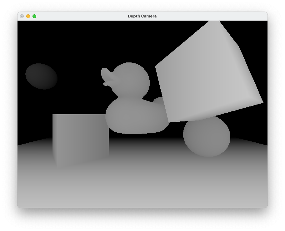

The depth camera is capable of generating both color and depth data. This example shows how to connect and receive depth data in the OnNewDepthFrame() callback function.
void OnNewDepthFrame(const float *_scan,
unsigned int _width, unsigned int _height,
unsigned int /*_channels*/,
const std::string &/*_format*/)
unsigned char *data = g_image->Data<unsigned char>();
ConvertDepthToImage(_scan, data, _width, _height);
It converts the depth image to a RGB grayscale format and copies it from the depth camera to a memory reserved in a globally scoped Image.
