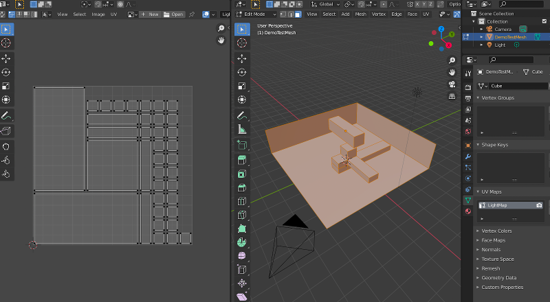

Step 2: UV Mapping
The next step is to create UV unwraps for your model. In Blender usually the first UVmap for any mesh created is for PBR textures and the second UV channel is for light map information. This secondary UV set is different from the UVs used to map things like color maps or normal maps because each polygon surface is receiving different lighting from all other polygons so each UV coordinate also needs to be unique.
For a fast automatic light map unwrap hit F3 and then search for “Lightmap pack”. Make sure to the “margin” is set to 1 for max distance between faces (reduces shadow bleeding during bake)

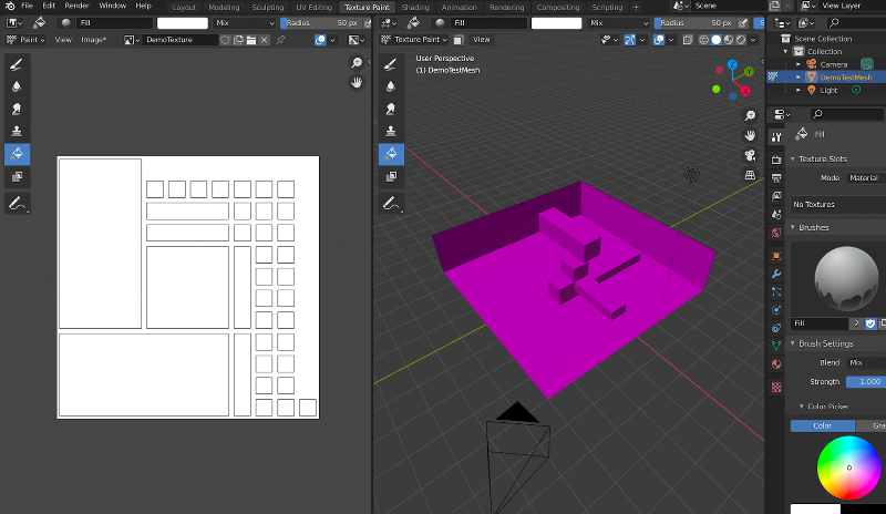

Step 3: Creating texture for model
With the model selected in “Object Mode” select the “Texture Paint” tab at the top of the tool bar and create a “new texture” for the model (make sure the Alpha is checked off).
This new texture should be applied to the Light Map specific UV island that was created in step 2
If the texture is black use the color picker and select the UV island and it should turn white (easier to see the baked shadows).

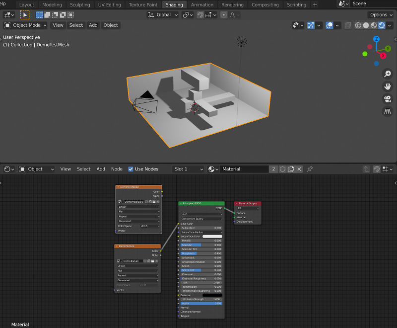

Step 4: Material setup / Baking

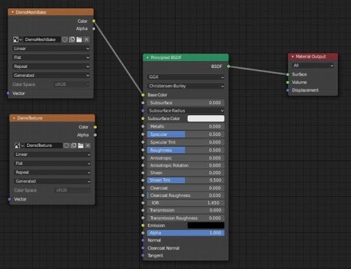

In order to have the texture show the baked lighting we must assign it to a new material. With your model selected open the Shader tab and select Add > Image > Image texture. This will create a new image texture node.
  • Add an image texture
  • Connect the color from the image node to the base color of the material color (principled BSDF)
After this step add another image texture in the shader editor
  • Give this one a new name (ex: MeshLightBake)

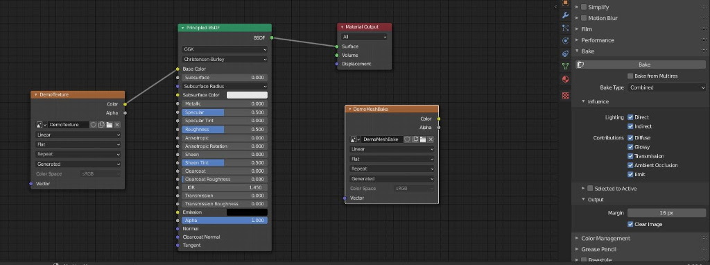

Now that the material node is set up, open the render properties and make sure that the cycles renderer active in the render engines drop down. Scroll down to where it says bake, and then with the second image node selected (MeshLightBake) hit bake. Blender should now start baking the light map for the model.

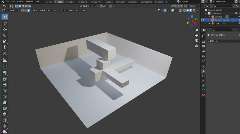

Step 5: Show Baked Lighting
After the bake is finished you should have a separate light map of your model.
  • To see it applied real time in your scene, go back to the hypershade / materials editor. Click on the Image texture that has the baked light map information and connect it to the base color.
Model with baked in lighting (Blender Viewport Shading turned on):

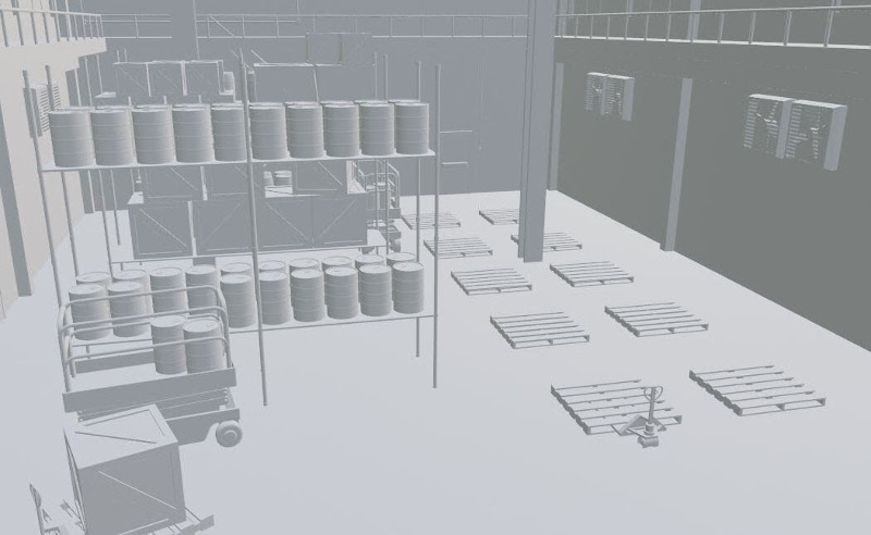

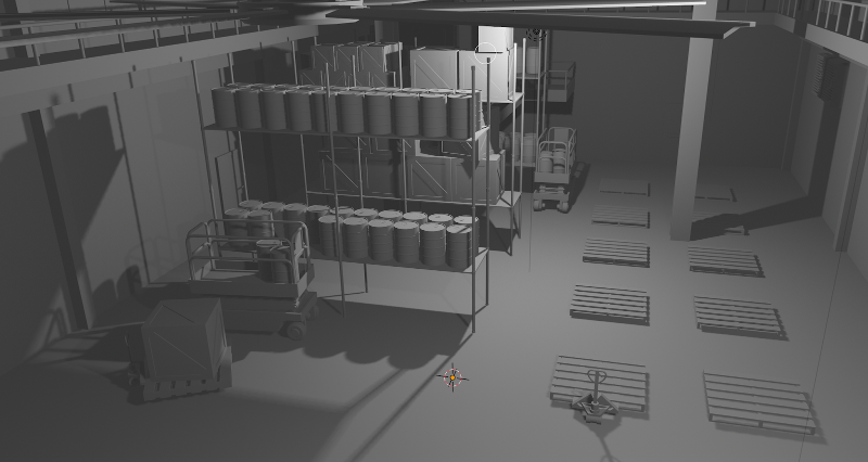

Light maps are great for working with bigger scenes. With baked-in lighting, complex meshes can show realistic lighting without using heavy computation (the Depot model below is a good example of complex scene with a baked light map).
