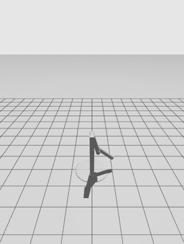

In this demo world, you should see a video recorder icon positioned on the top left area of the window along with other buttons. Clicking on the video recorder button gives you the video format options that are available.

Playback the video you just saved and you should notice that the resolution of the video is based on the size of your 3D scene window. So if you wish to record the video in a different size, make sure to configure the GUI window prior to recording.
