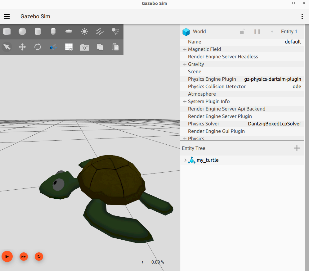

Load your model in Gazebo
Launch Gazebo and load our model:
gz sim ~/gazebo_maritime/models/my_turtle/model.sdf
You should see your model visualized as a mesh now!
