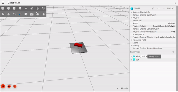

3) Run the following command to launch the gazebo simulation:
gz sim -v 4 -r example.sdf
This is how the model will look:

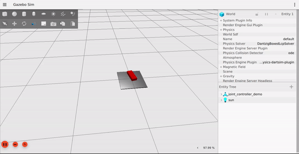

4) Now let's add the Gazebo JointController plugin to the SDF file. Add the following line to your file just before the tag </model>.
Note: All the plugins discussed here should be between <model> and </model> tags. Ideally just before the </model> tag for better readability.
  • Velocity mode
filename="gz-sim-joint-controller-system"
name="gz::sim::systems::JointController">
<joint_name>j1</joint_name>
<initial_velocity>1.0</initial_velocity>
The initial velocity is set to 1.0 rad/s.
One can change the joint velocity by publishing a message on the topic /model/joint_controller_demo/joint/j1/cmd_vel or can change the topic name within the plugin.
To change the topic name add the following line before </plugin> tag in the SDF file.
<topic>topic_name</topic>
  • Sending velocity commands
gz topic -t "/topic_name" -m gz.msgs.Double -p "data: 10.0"

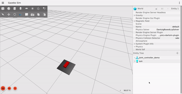

  • Force mode
Replace the velocity mode plugin mentioned above with the following lines in the SDF file for force mode.
<use_force_commands>true</use_force_commands>
<p_gain>0.2</p_gain>
<i_gain>0.01</i_gain>
This would look almost the same as velocity mode if PID gains are tuned properly.

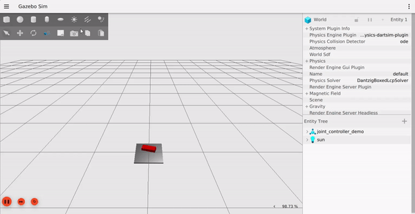

2) JointPositionController
  • Joint position controller which can be attached to a model with a reference to a single joint.
  • One can mention the axis of the joint they want to control.
JointPositionController uses a PID controller to reach a desired joint position.
All the parameters related to this controller can be found here.
Commanded position(cmd_pos) can be published or subscribed at the topic: /model/<model_name>/joint/<joint_name>/<joint_index>/cmd_pos by default.
Message data type: Double.
Example usage:
For this let's use the previously discussed SDF file.
1) Replace the JointController plugin with the JointPositionController plugin in SDF file.
filename="gz-sim-joint-position-controller-system"
name="gz::sim::systems::JointPositionController">
<p_gain>1</p_gain>
<i_gain>0.1</i_gain>
<d_gain>0.01</d_gain>
<i_max>1</i_max>
<i_min>-1</i_min>
<cmd_max>1000</cmd_max>
<cmd_min>-1000</cmd_min>
2) Sending joint position command.
gz topic -t "/topic_name" -m gz.msgs.Double -p "data: -1.0"

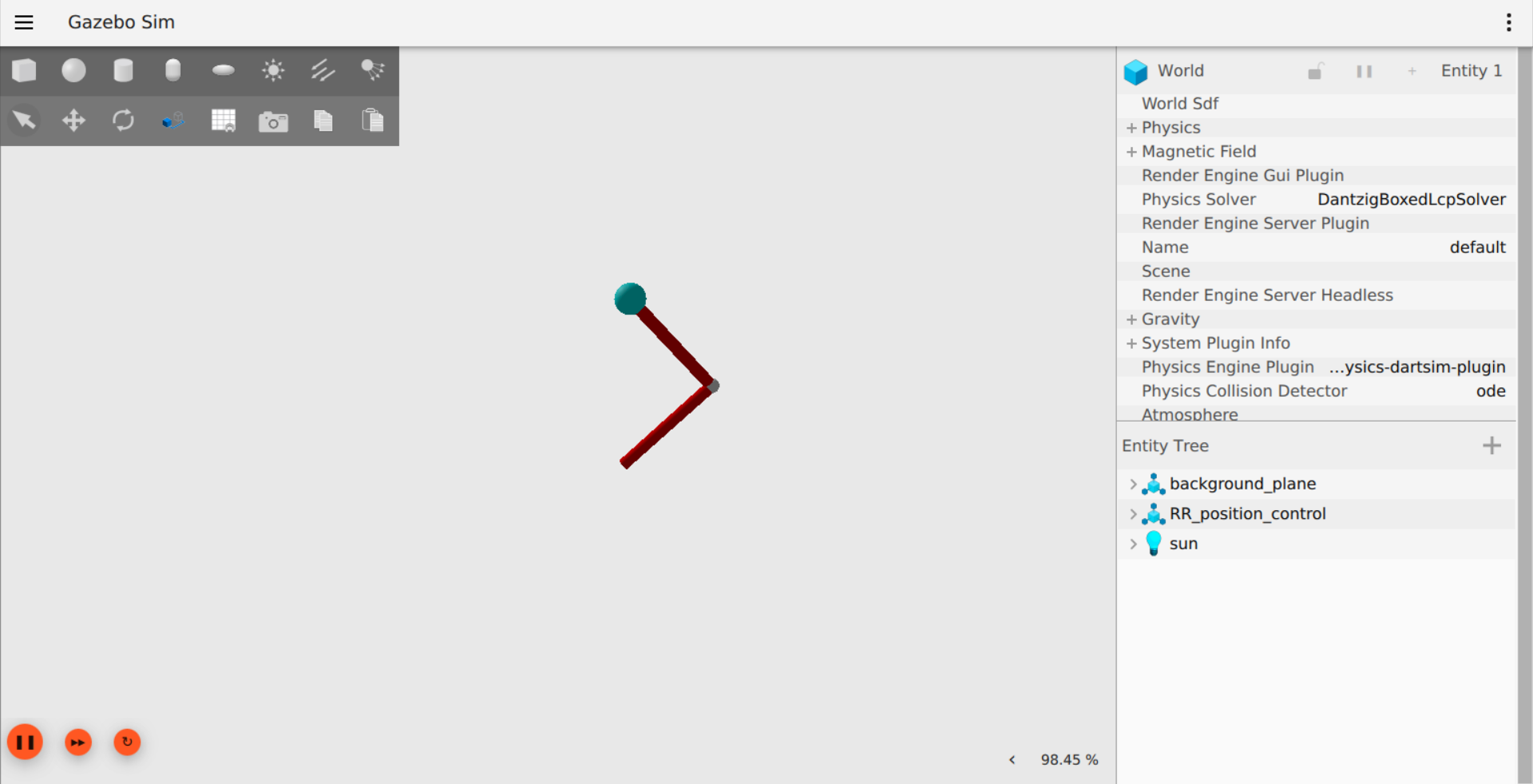

Let’s set up a new model for this example. A two-linked manipulator arm which has a total of two joints to control (joint_trajectory_controller.sdf is the original example). Name it as example2.sdf.
  • SDF file:

1) Launching gazebo simulation.
gz sim -v 4 -r example2.sdf
2) Adding the JointTrajectoryController plugin and let’s do position control for both joints.
Append the following lines before </model> tag in the SDF file.
filename="gz-sim-joint-trajectory-controller-system"
name="gz::sim::systems::JointTrajectoryController">
<joint_name>RR_position_control_joint1</joint_name>
<initial_position>0.7854</initial_position>
<position_p_gain>20</position_p_gain>
<position_i_gain>0.4</position_i_gain>
<position_d_gain>1.0</position_d_gain>
<position_i_min>-1</position_i_min>
<position_i_max>1</position_i_max>
<position_cmd_min>-20</position_cmd_min>
<position_cmd_max>20</position_cmd_max>
<joint_name>RR_position_control_joint2</joint_name>
<initial_position>-1.5708</initial_position>
<position_p_gain>10</position_p_gain>
<position_i_gain>0.2</position_i_gain>
<position_d_gain>0.5</position_d_gain>
<position_cmd_min>-10</position_cmd_min>
<position_cmd_max>10</position_cmd_max>
3) Sending trajectory message (Can also change the topic name).
gz topic -t "topic_name" -m gz.msgs.JointTrajectory -p '
joint_names: "RR_position_control_joint1"
joint_names: "RR_position_control_joint2"
points {
positions: -0.7854
positions: 1.5708
time_from_start {
sec: 0
nsec: 250000000
points {
positions: -1.5708
positions: 0
time_from_start {
sec: 0
nsec: 500000000
points {
positions: -1.5708
positions: -1.5708
time_from_start {
sec: 0
nsec: 750000000
points {
positions: 0
positions: 0
time_from_start {
sec: 1
nsec: 0
Note: by default velocity and position control are disabled if one wants to use this mode, they must specify the PID gains value according to usage.
In case, PID gains are not specified then by default force mode will work.
4) Checking the progress of the commanded trajectory.
gz topic -e -t "/model/RR_position_control/joint_trajectory_progress"
This returns the progress of the commanded trajectory which is a value between (0,1].
Finally, JointTrajectoryController can be used for hybrid control (e.g. In manipulator robots) where value from position PID, velocity PID, and commanded force value are summed up and applied.
