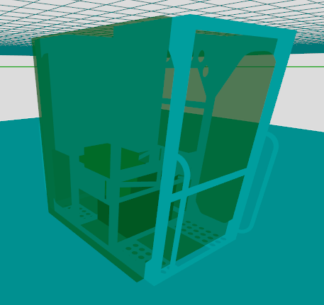

Adding visuals
Let's now add nicer-looking visuals to our lander. Download the following COLLADA mesh file from here.
mkdir ~/gazebo_maritime/models/my_lander/meshes
wget https://raw.githubusercontent.com/gazebosim/gz-sim/gz-sim10/tutorials/files/lander/inkfish-lander.dae -O ~/gazebo_maritime/models/my_lander/meshes/inkfish-lander.dae
Replace the chassis_visual element in your model.sdf with the following block:
<visual name="chassis_visual">
<mesh>
<uri>meshes/inkfish-lander.dae</uri>
</mesh>
And launch Gazebo to see the results:
gz sim ~/gazebo_maritime/models/my_lander/model.sdf
Your box should now be replaced with a better looking mesh.

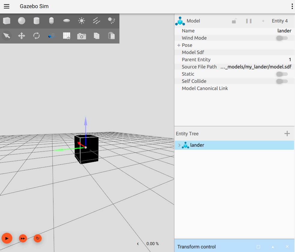

Checking frame of reference
Launch your lander in Gazebo as we did before:
You can visualize the frame of reference of your vehicle by loading the plugin Transform Control from the GUI.
Then, click on the vehicle, and then, click on the Translate mode icon. You'll now visualize your lander frame of reference. As this is the expected frame of reference, we won't need to apply changes in the COLLADA mesh or add any <pose> offset to our model.sdf.
