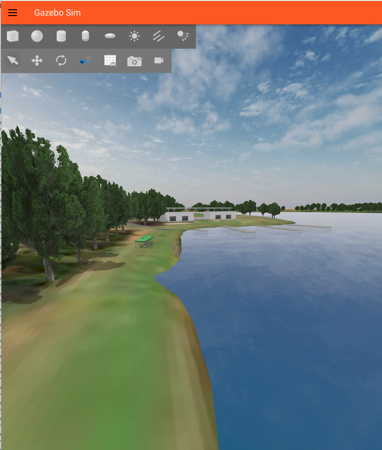

gz sim -r src/gazebo_maritime/worlds/sydney_regatta.sdf
Gazebo is loaded with the Sydney Regatta Center!

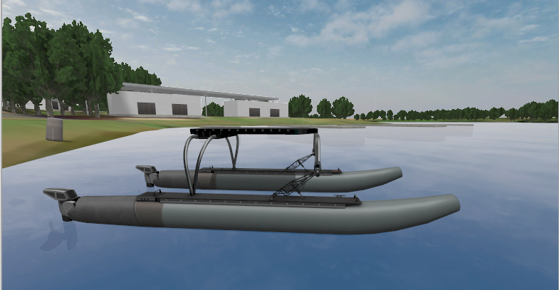

Uncomment now the following block in the sydney_regatta.sdf file:
<!-- Uncomment this block to load the WAM-V model-->
<name>wam-V</name>
<pose>-532 162 0 0 0 1</pose>
<uri>wam-v</uri>
And launch Gazebo:
gz sim src/gazebo_maritime/worlds/sydney_regatta.sdf
If you hit play, your WAM-V will sink (sad but expected). There's no buoyancy enabled yet.

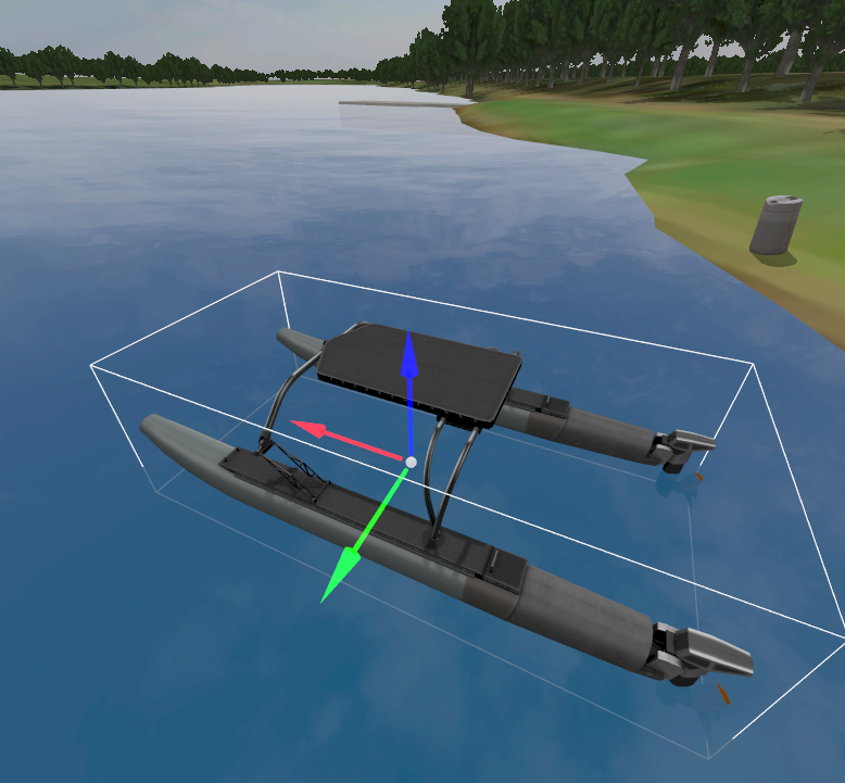

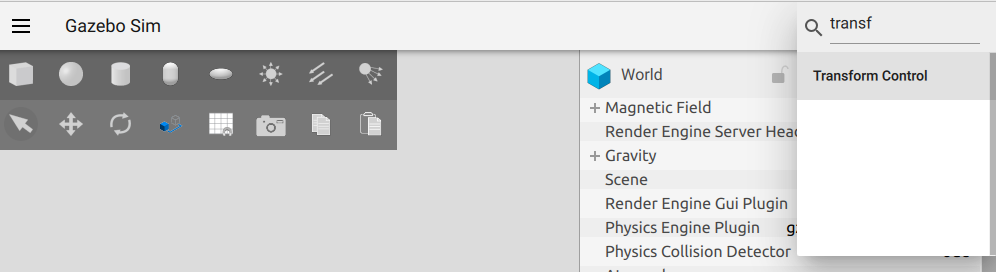

You can visualize the frame of reference of your vehicle by loading the plugin Transform Control from the GUI.
Then, click on the vehicle, and then, click on the Translate mode icon. You'll now visualize your WAM-V frame of reference. As this is the expected frame of reference, we won't need to apply changes in the COLLADA mesh or add any <pose> offset to our model.sdf.
