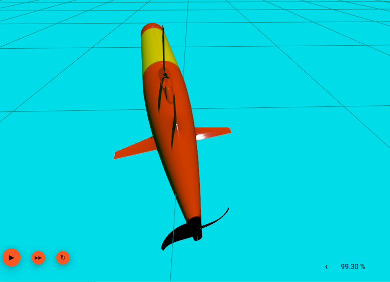

Let's run the simulation:
gz sim ~/gazebo_maritime/models/my_lrauv/model.sdf
You should see Gazebo with your LRAUV loaded. If you hit play, your robot will sadly sink. The good news is that this is expected as we did not attach any plugins to the LRAUV model. Let's do that!
