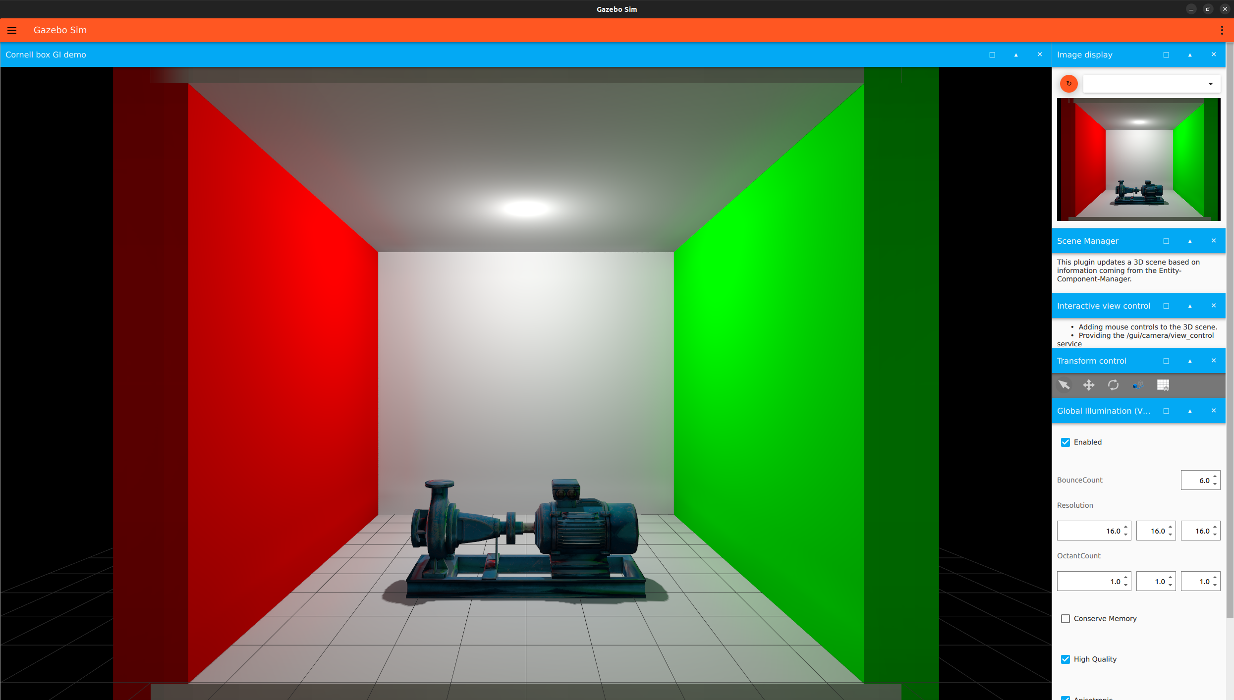

How to enable global illumination for the GUI
GI can be enabled for the GUI through a GUI plugin. Both VCT and CI VCT are supported for the GUI.
Example usage for VCT
1) Open the global_illumination.sdf world with
gz sim global_illumination.sdf
2) From the plugin dropdown, select the Global Illumination Vct plugin.
3) On the card, check the Enabled button to enable GI and change the parameter values as desired.
Example usage for CI VCT
1) Open the global_illumination.sdf world using Vulkan with
gz sim global_illumination.sdf --render-engine-api-backend vulkan
2) From the plugin dropdown, select the Global Illumination Ci Vct plugin.

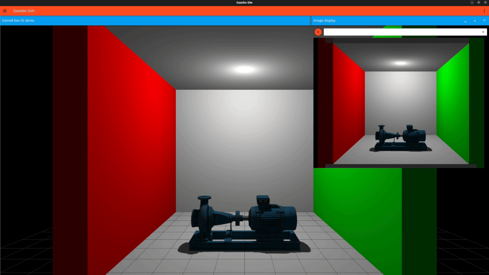

<!--camera sensor-->
<model name="camera">
<pose>-15 0 4 0 0.0 0</pose>
<sensor name="camera" type="camera">
<width>2560</width>
<height>1920</height>
<far>100</far>
<topic>camera</topic>
</world>
</sdf>
2) Add the <global_illumination> element to the Sensors System plugin.
<global_illumination type="vct">
<enabled>true</enabled>
<resolution>16 16 16</resolution>
<octant_count>1 1 1</octant_count>
<bounce_count>6</bounce_count>
<high_quality>true</high_quality>
<anisotropic>true</anisotropic>
<thin_wall_counter>1.0</thin_wall_counter>
<conserve_memory>false</conserve_memory>
<debug_vis_mode>none</debug_vis_mode>
</global_illumination>
The parameters can be changed from the default values.
3) Open the gi_demo.sdf world with
gz sim gi_demo.sdf
