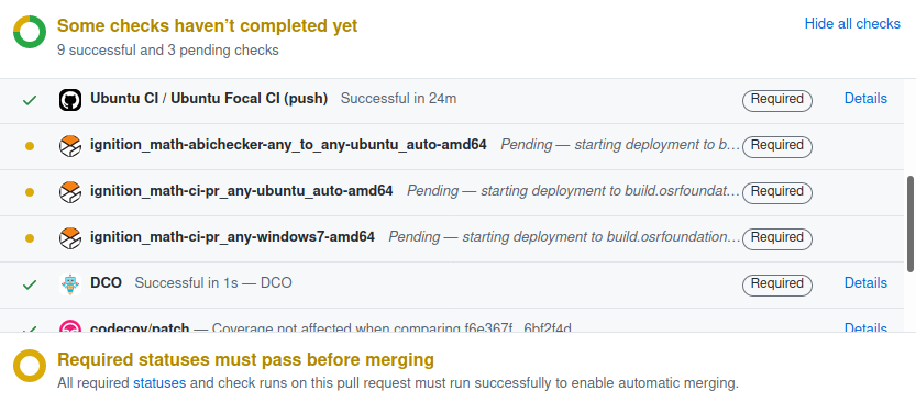

All checks are visible at the bottom of a pull request, for example:
PR checks

Required checks#
Some checks are marked as Required. This means the pull request can’t be merged unless that check is green.
Ideally, all checks would be required. But known warnings, test failures and flaky tests often prevent us from marking them as required, otherwise no pull requests could be merged. Until these are addressed, some checks will need to be checked by hand when they fail, to see if those failures are unexpected. See this issue for what checks are required for each library.
Interpreting results#
On the GitHub UI, checks can be:
  • ✅: Passed, all good!
  • 🟡: Pending, results haven’t been received yet.
  • ❌: Failed, something is wrong.
Depending on the library and on the build queue (from our Jenkins server), checks can be in a pending 🟡 state from a couple of minutes up to an entire day. If a build is in this state for too long, there may be some issue with infrastructure and the build didn’t run or didn’t report back.
Failing builds ❌ usually require more investigation:
  • If the build is Required, something is definitely wrong and must be fixed before merging the pull request.
  • If the build is not required, investigation is needed to find out if the failure is pre-existing or if it is being introduced by the pull request.
Clicking on the Details button of a failing build takes you to the build so that you can inspect it.
