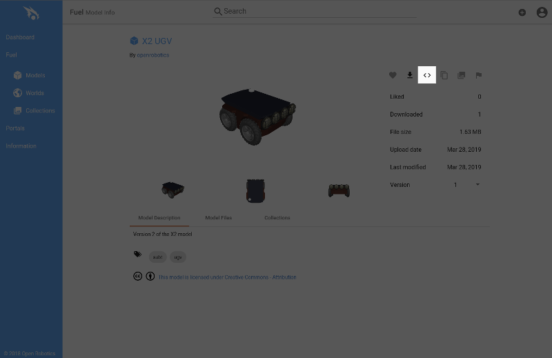

There are a wide variety of simulation resources at your disposal on
https://app.gazebosim.org/fuel.
If you find a model you’d like to use, then click on the <> icon in the
model description page, highlighted in the image below, to copy an SDF
snippet into your clipboard. This snippet can be pasted directly into your
custom SDF file.
