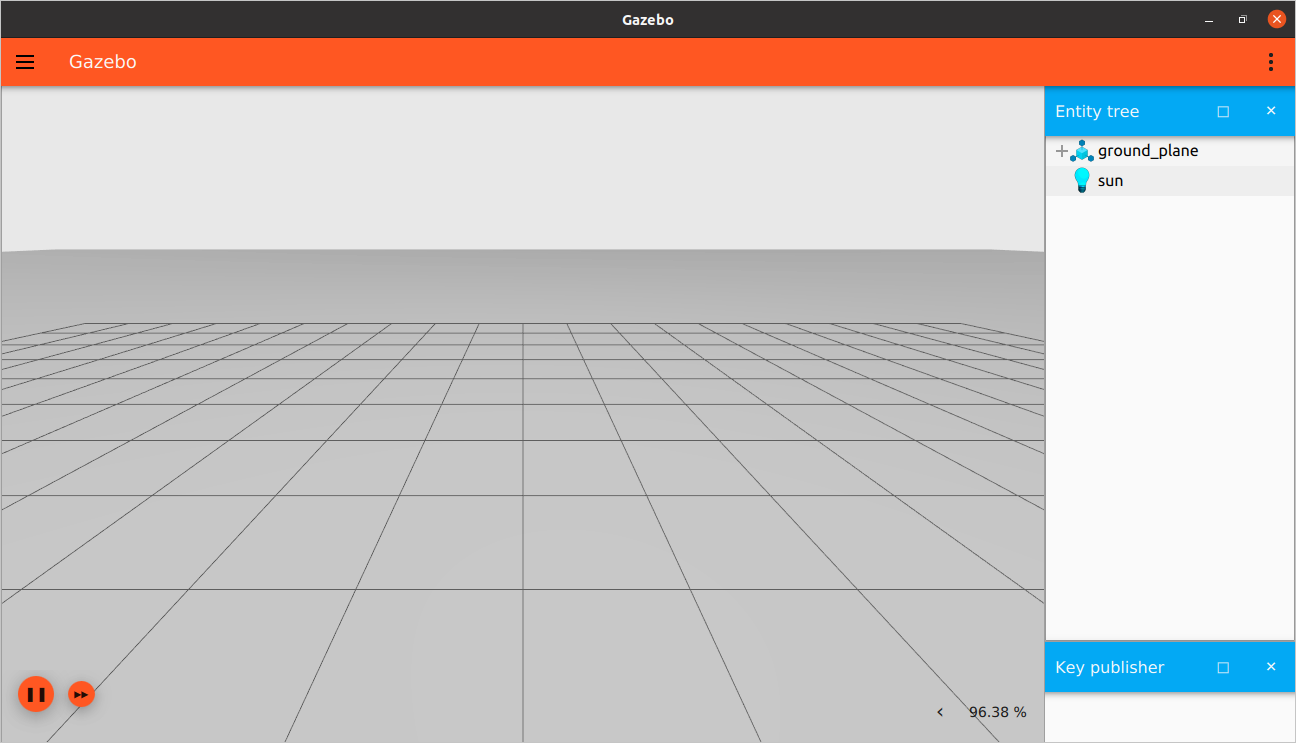

Publish key strokes to ROS#
Let’s send messages to ROS using the Key Publisher an Gazebo plugin.
Note: Make sure to have all workspaces you need (ROS, Gazebo and, ros_gz…) sourced.
First we will start a bridge between ROS and Gazebo specifying the topic at which the Key Publisher plugin sends messages and also the type of the messages as follows:
ros2 run ros_gz_bridge parameter_bridge /keyboard/keypress@std_msgs/msg/Int32@gz.msgs.Int32
We started a bridge on /keyboard/keypress topic with message of type Int32. For ROS it is std_msgs/msg/Int32 and for Gazebo it is gz.msgs.Int32
In another terminal launch an Gazebo Sim world, for example the empty.sdf world:
gz sim empty.sdf
Then add the Key Publisher plugin from the dropdown menu on the top right corner.
empty_world_with_KeyPublisher
In another terminal start the ROS listener:
ros2 topic echo /keyboard/keypress
This command listens to the messages sent over the /keyboard/keypress topic.
On the Gazebo window, press on the keyboard keys and you should find data on the listener terminal.
Now it’s your turn! Try to send data from ROS to Gazebo. You can also try different data types and different directions of communication.

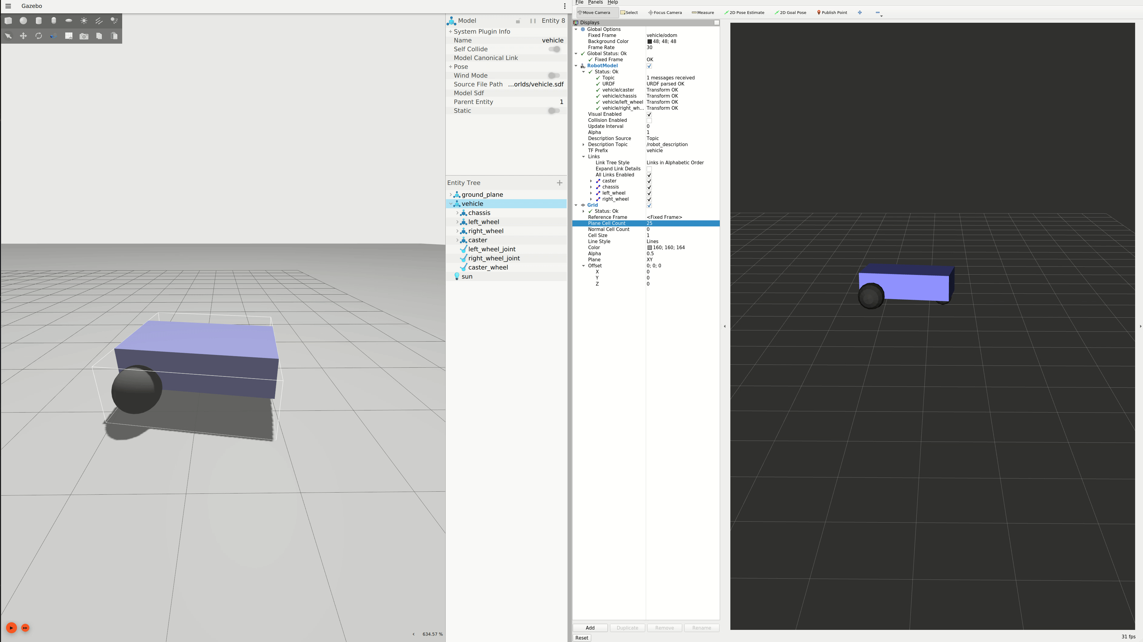

Visualize in RViz#
Take a step further and try out demos from ros_gz_sim_demos.
For the sdf_parser demo, install ros_gz and the parser plugin sdformat_urdf from source in a colcon workspace. Read more about sdformat_urdf here.
Run the demo launch file with the rviz launch argument set:
ros2 launch ros_gz_sim_demos sdf_parser.launch.py rviz:=True
Start the simulation in Gazebo and wait a few seconds for TFs to be published.
In another terminal, send either ROS or Gazebo commands for the vehicle to move in circles:
gz topic -t "/model/vehicle/cmd_vel" -m gz.msgs.Twist -p "linear: {x: 0.5}, angular: {z: -0.1}"
ros2 topic pub /model/vehicle/cmd_vel geometry_msgs/msg/Twist "{linear: {x:0.5, y: 0.0, z: 0.0}, angular: {x: 0.0, y: 0.0, z: -0.1}}
And verify the vehicle matching its trajectory in Gazebo and RViz. Note that the sim here is running 5 times faster than real time
gz_rviz
For more details on implementation of this demo see ROS 2 Interoperability.
