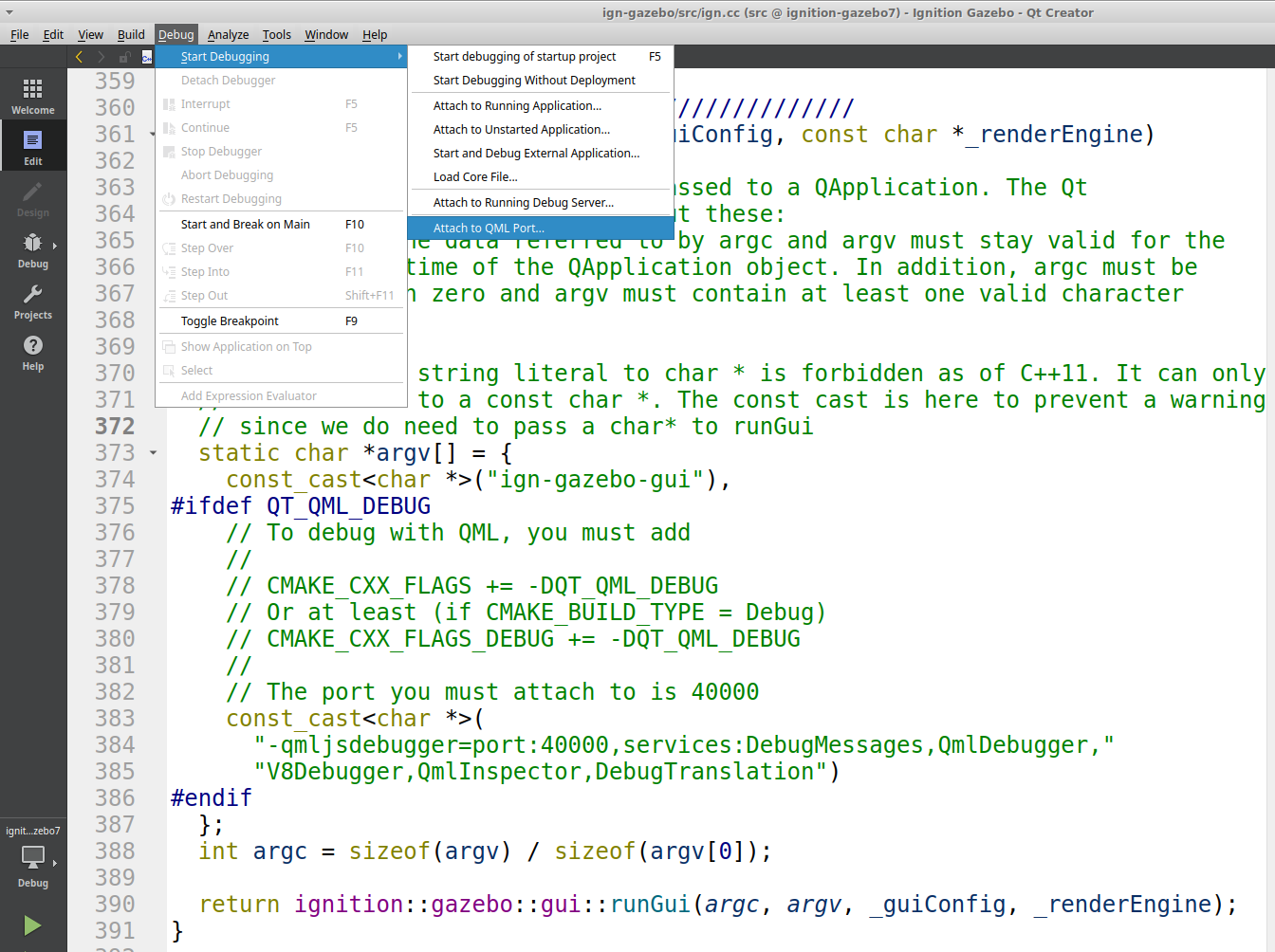

After that you can just head to QtCreator -> Debug -> Start Debugging -> Attach to QML Port... and enter the QML port

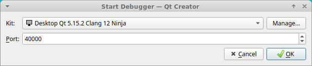

Once you click there, set the port number to 40000 and hit ok
