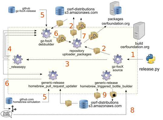

Processes triggered when using release.py#
The following picture shows the interactions triggered when using the release
tool release.py explained in this guide:
Actions for releasing a new version of library gz-foo with major version X:
release.pywill tag the local repository and call thegz-fooX-sourceJenkins job to generate the sources corresponding to that tag.gz-fooX-sourcewill generate a tarball with the source code of the new version and callrepository_uploader_packagesto upload the tarball toosrf-distributions S3.gz-fooX-sourcewill call_releasepywith the tarball URI information._releasepywill start the following jobs in the build serverbuild.osrfoundation.org:gz-fooX-debbuilder: multiple calls for different Debian/Ubuntu releasesgeneric-release-homebrew_pull_request_updater: one call for Homebrew macOS release
build.osrfoundation.orgjobs start the work of creating releases:gz-fooX-debbuilder: use tarball with release sources and metadata fromgz-fooX-releasegeneric-release-homebrew_pull_request_updater: usehomebrew-simulationrepository metadata together with the release sources
The output of the first round of initial jobs triggered by
release.pyis different:gz-fooX-debbuilder: builds the Debian/Ubuntu .deb packages and passes them to therepository_uploader_packagesjobgeneric-release-homebrew_pull_request_updater: opens a new PR to coordinate the release process inhomebrew-simulation
repository_uploader_packagesimports the packages created by thegz-fooX-debbuilderjob (there will be one build for each platform combination of Ubuntu/Debian release and architecture) and uploads the .deb packages topackages.osrfoundation.organdosrf-distributions S3.For macOS, the PR in
homebrew-simulationwaits for a comment from an Gz developer with the orderbuild bottlethat will trigger the jobgeneric-release-homebrew_triggered_bottle_builder.generic-release-homebrew_triggered_bottle_builderwill use the tarball with release sources fromosrf-distributions S3to generate the binary bottles. They will be uploaded toosrf-distributions S3.
