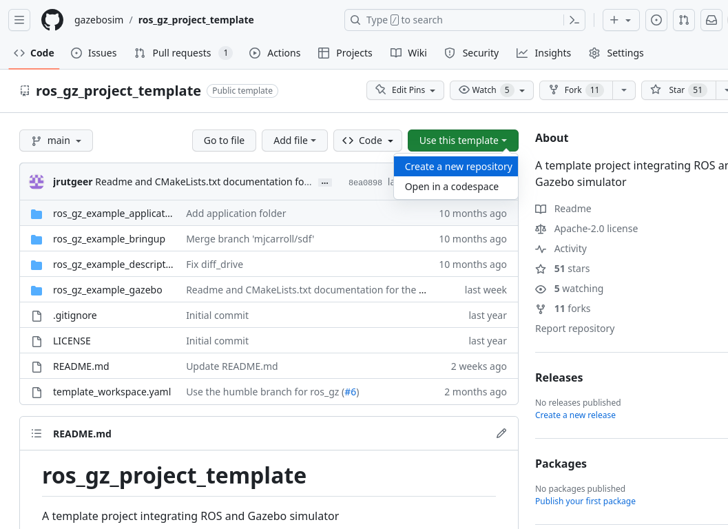

  2. Directly use the ros_gz_project_template template and create your project repository on GitHub.
    use_template
    Or start by cloning the template repository:
